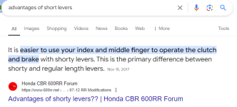

What are the advantages to shorty levers? Are they closer to the grips?
I think there is also a scientific or mathematical explanation for them as well.
If you do a one or two finger pull, they don't hit your other fingers. That gives you about a 1/2" more useful travel (so you could start them closer or have a different pull ratio to allow easier modulation).
I tend to drop my bikes and the longer stock levers kept snapping off. Shorty levers aren’t as wide as the bars so they don’t break, which is great because then I don’t need extra levers when I go on trips.
I like how they look better.
Never had a problem with the 2 finger pull on stock levers.
Do shorty levers require more effort to pull? (decreased leverage)
Theoretically yes, but most people use more force with the index and middle finger anyway even if they use four fingers on the lever. Pull the lever yourself with four fingers and you'll see what I mean. Ring and pinkie aren't exerting much force.
Before I moved to shorties, I always used one finger pulls anyway, the rest of the fingers are on the bar as an anchor so you have better control of the steering. Got tired of having the clutch lever hitting the back of my other fingers, so I went to shortie levers. The extra leverage required is not even noticeable.
