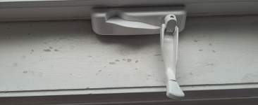

Need some ideas.
I need to repaint some windows frame/casings. Damage from dog etc.
Whats the best approach?
Rough sand paper then finish it with a fine grit and repaint?
Or should I use some sort of paint remover and repaint?

Light sanding and a light fill (if required) then an application of trim paint.

How perfect do you want? I would probably sand (with da hooked to vaccuum) and repaint. Good enough. You will still see some marks unless you sand all the way down or fill the chips. It's a house that you live in with dogs and kids not an art gallery. I'd be ok with the low effort approach and fresh paint.
@GreyGhost as best as I can get it but I don't expect it to look like new or museum quality.
At the same time I know it will only be a temporary solution as in that it will happen again. This windows is only about 1.5 feet off the ground and she loves to look out the window.
I was thinking of sanding as much as I can and refill with wood filler if/where needed.
There is another spot in the house with dive divots from the hand crank.
Clear 3M vinyl is your friend after you get the paint sorted. Get a small roll off Amazon and put it over the paint wherever Fido tends to park her paws. Keeps things looking fresh and is easy to replace if you get lazy with the pooch's pedicures.
Great idea.
Looks like they have many options available.

Lots of these transparent pet-protector style things on Amazon, but I'd think about heading down to the big box hardware store and looking at the plastic door/window/trim section to see if anything in white would work so you can skip the painting entirely.
Or be a baller and install a slab. I suspect places that sell counter tops could have a lot of scrap that would make nice sill covers. It may interfere with his crank though. I grabbed a couple installation cranks so I can leave them on with my stupid california shutters but I'm not sure you can use that style crank with the fancier folding cranks.

Skipping the painting probably wont fly with the designer.
I will try to the sanding/painting first then some protective film. Either the clear 3M or the one @Ash mentioned .
Get white protective film and no painting needed....
Most likely wont work with the crank but a great idea.
