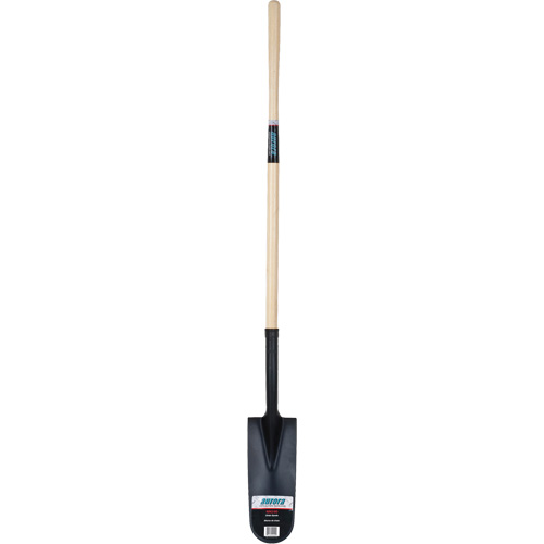

You only need to trench down a bit more than a foot if you drop a PT plank over the buried cable. A $25 trenching shovel will make short work of that.
A lot more than a foot. Top of conduit is at 18 in. Need 3" of sand below. So you need the better part of 2' with a plank. No plank is 6" deeper.
Cable is 300mm below grade if there is a plank and no vehicular traffic. Add another 50mm for a sand base. I think thats about 14".
