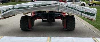

I have never heard of snapped off grooves , using clips the screws would spin out before breaking a grove off , or run right through for the fellows using a toe nail idea. But lots of wierd stuff happens They went single sided on the material when they started doing a vinyl encapsilation , the 'cap' is very expensive in the manufacture. The down side is you now only have one working side in a really expensive product. Lumber yard lift truck guys picking up 20ft have 8ft hanging off each side of the fork . The warehouse where its loaded has a steel jig to pull orders , from the factory it ships on pallets , but only the guy ordering the full lift gets the skid....

If you're MP's delivery guy that leaves the forks 18" apart when moving lifts, overhang is far worse. What a moron, at least pull the forks apart as much as possible when moving long flexible material.
when you offload a Moffat lift truck , from the tag along spot on the big truck, the forks are usually inset a bit , moving them requires about 2 mins of extra effort. Because then you have to move them back.
Hate shipping on a Moffat truck , you loose a lot of capacity , because you have the tag along hanging off the back.
