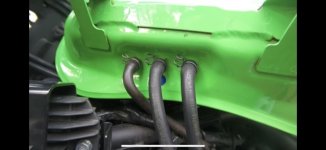

Having said that, during the removal process, I realized that there is a hose that is supposed to be connected to the left side of my bikes tank, however, on my bike it was not connected.
See this photo from youtube as reference
Although, on my bike, there is only one single hose, not three. Anyone know this things purpose?
Tank overflow.
Venting.
Third is likely California emissions junk, that's why yours doesn't have it. Likely goes to a carbon canister.
