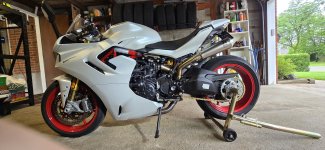

So, with the M1000R out of the picture, I have decided the only logical way to proceed is farkles for the Supersport. Yes, I know I have a problem.... just let it go.
Yes I know I bug @Evoex about his farkles... but those are different farkles..... mine are fine.

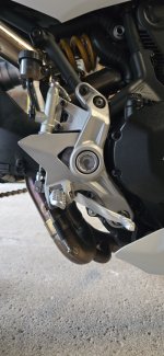

Where we started....
Brake.
Shifter.

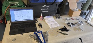

Spent some time prepping the garage so I didn't end up in my usual mess of tools and parts everywhere..... Even pulled out an ancient laptop for schematics and torque specs.

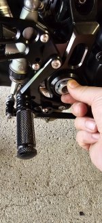

The only real pain with the installation is the the main swingarm bolt. It is some weird 12 point fitting. It is not a 'triple square', it's just weird.
The consensus online is to use a 5/8 - 11 nut. The cross section is 15/16" [.937" (23.8mm)] which is very close to the 24mm Allen that you can also use. Who has a 24mm hex bit?

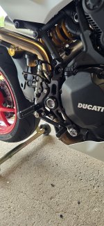

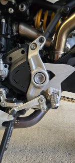

Anyroad.... I think it turned out quite nicely. Still need to bleed that back brake as this system uses a pressure switch for the brake light as opposed to the limit switch from Ducati.
Thanks for looking......
