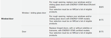

I'm getting the first test done on Jan 16 as I am looking to replace windows and doors in the new place (most are original, 1986)

Windows are a pretty crappy ROI in the program (125 or 250 per rough opening depending on the energy rating of the new windows). Now, if you are doing them anyway, I don't see a down side. Depending on window design, the program may barely cover the tax.

I spoke with my installer (the guy I recommended to you), and he basically said 'the requirements for the rebate / grant are such that you pay way more for the windows that it doesn't actually save you any money'.
Apparently the windows that qualify are considerably more expensive than normal windows that don't qualify for the grant...so even after the rebate, you get screwed and never actually save any money compared to just doing it.

When I did my windows 4-5 years ago, my windows guy told me the same thing.
Only specific window are approved. By the time all the paperwork and approval is done and you pay the tax, you may save a few bucks for a cup of coffee.

Agreed - The rebate alone program is not worth the time investment for window/doors.
But the 0% loan is what we are after and the rebate is also included. In my opinion worth it over paying out of pocket.
