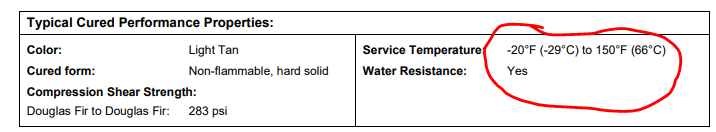

I'm thinking PL to stick the brick onto the scratch coat, but it's only good down to -18C...so maybe not the best use of this product.
I think I'm going to be stuck with using the mortar bonding agent :(
EDIT: Although this looks promising....
