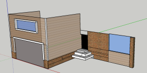

Not too shabby with my minimal Sketchup skills...
Is brick flush with siding or sticking out? Your garage door trim and corner trim needs to die at a visually strong surface. If brick sticks out, it can stop there but if brick is flush, trim needs to go to the ground. Floating trim feels very wrong. You could also run a band of trim board between brick and siding if you want the trim to die above brick. In non-retrofit applications, they normally have a stone or brick lintel for that transition to give a base for trim and a visual separation (and keep some water from running over masonry).
Good comments.
1. Brick would be closer to wall than siding
2. Never considered the trim horizontally
3. Thought about a lintel but not sure yet
4. Brick isn’t going around the whole house. It would go to the gate and then I’d have a 27” high stucco strip from the base of the house
5. In pic 1 we’re not decided if the brick should go between the front facade do the door. Those stairs screw up the flow.

With inset brick, trim to ground doesn't really work either.
Not sure how to attach a visually appealing lintel that is almost entirely cantilevered. I guess you could use angle iron against the house and fasten it hanging from your framing to support the cantilever. I don't like that though. Odds are, at somepoint, someone will climb on it and you will have a 200 lb point load at max distance.
I would probably do a horizontal trim board to break up the transition and hide a drip edge to kick the water running down the wall away from the brick.
Not sure how accurate scale is but I wouldn't love the brick returning half way up a step. Brick to door sill makes sense visually. You could transition from that height down to your desired 27" height at the gate as it would be hard for anyone to see both sides. Why 27"? You want the step to be a full board, you don't want a cut at the bottom. That is assuming shiplap as shown. Board and batt is more flexible with step height.

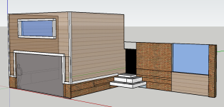

Good call @GreyGhost looks much better...

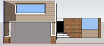

Not sure how to incorporate the trim into the right window...
You can see the transition from brick to stucco...

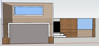

Make sure vertical trim rests on horizontal pieces. Trim theoretically represents columns so they need to sit on a surface to look proper. I assume the orientation shown was to ease modelling (as with trim dying at edge of step).
What colour are window frames going to be? How are you dealing with deeper window lintels? You can get away with some above the garage as it isn't so visible but standing at the front door they can look directly down into your LR window treatment. How much space above living room window and below soffit to accommodate trim?
1. Yes, vertical trim will sit on horizontal
2. Window frames will be white (same as trim)
3. Normal flashing just deeper
4. Window guy coming tomorrow to quote new windows. Depending on the price, we may just buy the window ourselves and install with my dad (he said he's got the strength still). Then we will push the windows out a few inches to lessen the offset
5. Zero space above living room window and soffit (same as other windows).
I don't know about the JH below the LR window. Trimming that window and having it look decent with no space above isn't easy. If you have some space, you can trick the eye but you don't. Horizontal transitions from brick to JH won't be trivial (Is that JH out 2" from the brick as well?). If JH is out from brick you can trim boxout as corner of garage. Trim dies at lintel. I'm worried about beltline left of door not lining up with belt line below LR window so I don't think I would put trim below window. If I did put trim below window, it would be wider so bottom of window trim matched bottom of belt line. You could probably get away with the thicker trim as a lintel but you would need to copy that detail to garage window as well. Other sides of the house could have normal trim.
