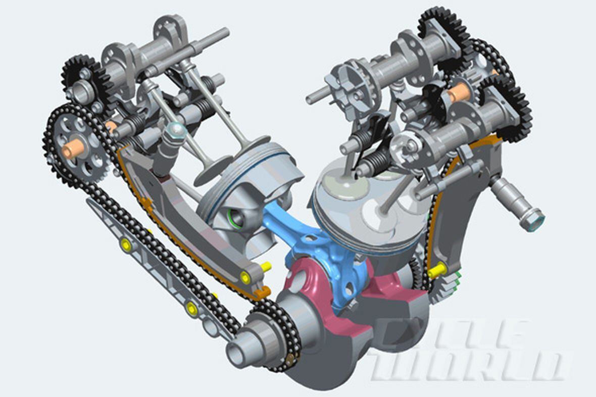

Correct, no springs to overcome -- but they do have a lot of stresses related to the inertia of rocker arms. You can't use rollers (as you see in the spring valves above), that's why the hard chrome the friction surfaces on Duc rockers. If they didn't, the friction related to overcoming rocker inertia would quickly wear the rockers away. Ducati has suffered well known challenges as the hard chroming in some production runs failed prematurely.
Ok, now take a look at the parts diagram for your FJR1300.
The DOHC that I showed has roller rocker arms, your bike doesn't you have cams that ride on buckets. That's the cheapest possible way it could be built :| if a Ducati has issues, your Yamaha has the same or worse issues.
Rollers are used when necessary, needless weight and mechanical parts that are unnecessary in an FJR. It's a light valvetrain that only overcomes the inertia and tension of valve springs up to 9000rpm. Remember, this is a different class of dependability engineering, to compare a Yamaha to a Duc would be like comparing a Fiat to a Toyota. Most FJRS never ever see a valve adjustment in their life, I've seen plenty at 200,000KM that have never fallen out of spec.
In a similarly powered Duc, say a MS1200, the motor has to work faster to make the same hp/torque. The Duc also has to contend with valves and the weight/inertia of rocker arms. That's why they wear and require frequent adjustments and belt replacement.
