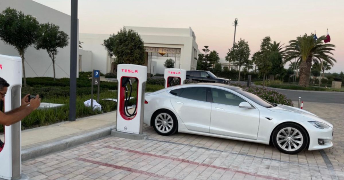

Let's hope this new charging network adopts the NACS Tesla standard & also offers other options as the market slowly decides which plug type will be left standing at the end.
They're saying they'll use both CCS1 and NACS connectors. There are a few hundred thousand vehicles built by these companies with CCS1 connectors already on the road (mine is one of them) and there's going to be probably a couple hundred thousand more over the next few years, so CCS is going to be around for many years.
The plug is the least of my concerns. There's going to be adapters between CCS1 and NACS. What this needs to sort out, is the payment methods. No more accounts to set up! If they arrange for "plug and charge" (the payment gets sorted out through communication of the VIN of the vehicle that plugs in) then make it work EVERYwhere. If they use an RFID tag for vehicles that can't do "plug and charge" then make the same RFID tag work EVERYwhere. If they insist on phone-app crap (and if you want to charge a non-Tesla at a Tesla supercharger, this is how it's going to be unless Tesla retrofits payment terminals, which they appear loath to do) then make it ONE phone app that works EVERYwhere and make Tesla play along. If they do something (either "plug-and-charge" or RFID tag) that requires setting up an account then make it so that it only has to be done ONCE. Not once per charging network ... ONCE.
That's what needs to get sorted out. The shape of the plug doesn't matter. The charging stations and networks and vehicles all need to talk to each other.

Nope. NACS just combines Tesla's connector with CCS communication protocol (in order to make them compatible via a physical adapter).
But ... Just because a Tesla supercharger recognises a Tesla vehicle when it's plugged in and recognises the VIN and correllates that VIN to a payment account set up at a Tesla server ... doesn't mean it's going to work when a vehicle with a mystery (to Tesla) VIN plugs in.
Tesla owners haven't seen these issues when charging at Tesla superchargers because Tesla is end-to-end responsible for the whole thing. As soon as you start mixing and matching charging station manufacturers, and vehicle manufacturers, and charging network operators, and payment methods, and everyone has to be capable of talking to everyone else, this all gets a LOT more complicated.
Tesla has built a small number of supercharger stations with the "magic dock" to allow non-Tesla vehicles to charge, but you still have to muck around with phone apps because Tesla superchargers don't have any other way of having someone pay for the charge. It's no better than charging the same non-Tesla vehicle at some other charging station. And apparently the superchargers don't work very well with vehicles that have 800v architecture (Hyundai).
And I've seen it the other way around, too. I got back to my car which was successfully completing a charge at an Ivycharge station (CCS) and found a Tesla owner beside me who couldn't get it to work. The difference was that I had the Ivycharge RFID tag and he didn't. BUT ... This approach doesn't work universally unless everyone agrees to use the same RFID tags and deal with cross-network payment ... because if every charging network has their own RFID tags and their own payment accounts then you need thirty different accounts and thirty different RFID tags, and that is no bueno.
There needs to be a universal cross-recognised method of paying for a charge. AND WE HAVE ONE. *cough* Credit cards!
Drive up to the charging station. Doesn't matter which car and doesn't matter which charging station. Plug in. Tap the credit card if your car doesn't have Tesla-style plug-and-charge (otherwise you can simply skip this step). It starts charging. DONE. That's the way it should work. It works like that at petrol stations, why shouldn't it work like that at charging stations?
