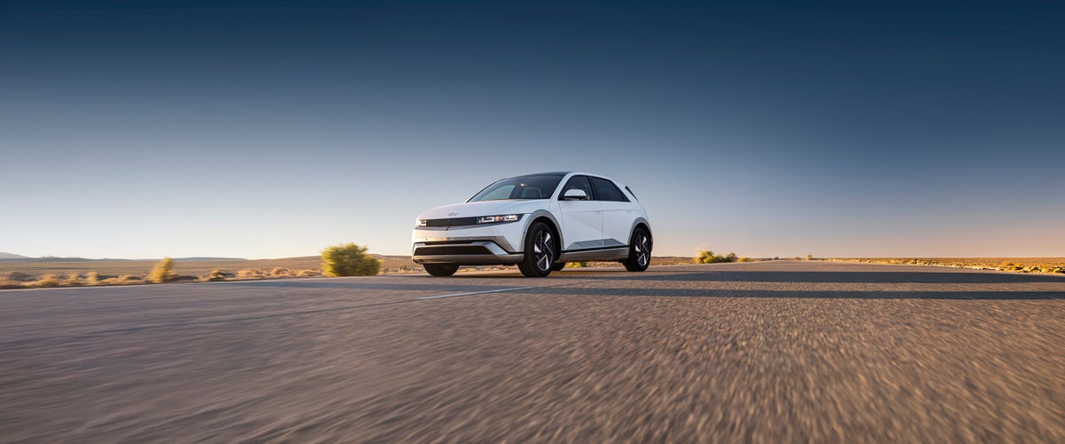

Just had a longish Uber in Ioniq....very impressive.
Huge range - 500-600k ...very comfortable. Said he loses 10% with ac on.
One of my wifes coworkers has one. They have nothing bad to say about it.
