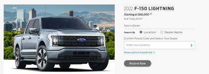

I'm liking this new F150. If I needed, and could afford it, I'd have one of those in my driveway. With our usage patterns, it would literally meet 99.9% of our needs.
I read somewhere that the base level trim is around 80k out the door CAD?
EDIT: Yup...around there. 68k base.
