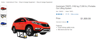

It will likely be cheaper at costco. I've thought about them before but there a few different models and the ones that would work well for my car are not great for my wifes and vice versa. After today, I am starting a lift fund. Getting too old for this crap. Two post lift will be installed when I cam find one for cheapish.
Surprise surprise.
But it does come with a very forgiving return policy .

Different lift. Costco has an extra 2000 lbs capacity. With the pudginess of evs, I dont think I would buy a 5000 lb lift if I was paying retail prices.

$2000 delivered
Too rich for my blood. I might end up building something with plywood, 2x and casters. I had my project bike on this stand for most of the last few months: https://www.princessauto.com/en/2-1-4-ton-4-in-1-multi-purpose-jack/product/PA0008936932
