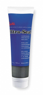

Trailer places sell B as an upgrade -- I don't know why as A is the preferred method of wiring. The advantages of A:
- an open ground impacts just one lamp. not all the lights on your trailer
- fewer wire to wire connections
My experience with trailer wiring is the failures generally happen at the connection points AND in the bulb sockets. On my trailers, I always:
  • slather GROTE Ultra into every socket and over every screw connection to ground, and inside the cable connector ends. It goes on sale at PA for $4/tube frequently - cheap insurance.
  • use the beefier 7-pin connectors. 4 pin connectors are the most common failure points in trailer wiring.
  • never use crimp or piercing connectors -- always solder and heat shrink (with Grote Ultra inside the heat sharing -- I use that **** on everything electrical)
  • add a ground strap between hinged parts (tongue and folding points on a trailer) as ground continuity can be intermittent through hinges.
