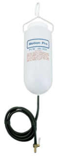

I didn't have an elevated tank to use today. I did have one of these, which would have been perfect, but lost it in the spring.

But now I'm wondering, what would feeding the carb (directly?) by gravity show? I know that with fuel provided at the carb inlet it will run.
Or did you mean trying to feed the pump by gravity?
