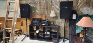

1960 watts of entertainment while I installed the heated comfort seat on the Super Duke and gave it a wipedown. The roads are wet, salty and sandy so this is the best I could do today. And yeah, I need to sell a bunch of old stuff I have from my rental properties that is doing nothing, the lamps etc. being obvious.
