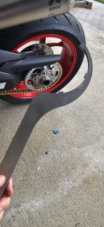

You made that at work? Can you take a photo showing it in use?

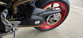

Ducati chain tension is done with an eccentric hub. You need a 125mm hook spanner.
You can buy them on Amazon for fairly cheap, but I had a sheet of 1/4" 304 SS at the waterjet already.
Water jet? Wow.
You have access to cooler tools than me!

The scrambler is a standard swingarm, I believe. No special tools required.
The wrench I needed is for the single sided swingarms.
Come for burgers tomorrow..... I made one for @Wind Shear as well.
Or hold the brake on and rock the wheel back and forth.
Be VERY careful torquing the eccentric bolts.
It's a single T60 bolt on mine. So you do not have the two bolt dance.
The wheel rocking method sounds interesting, I will give it a shot next chain adjustment.
Always good to know different ways to do things.
