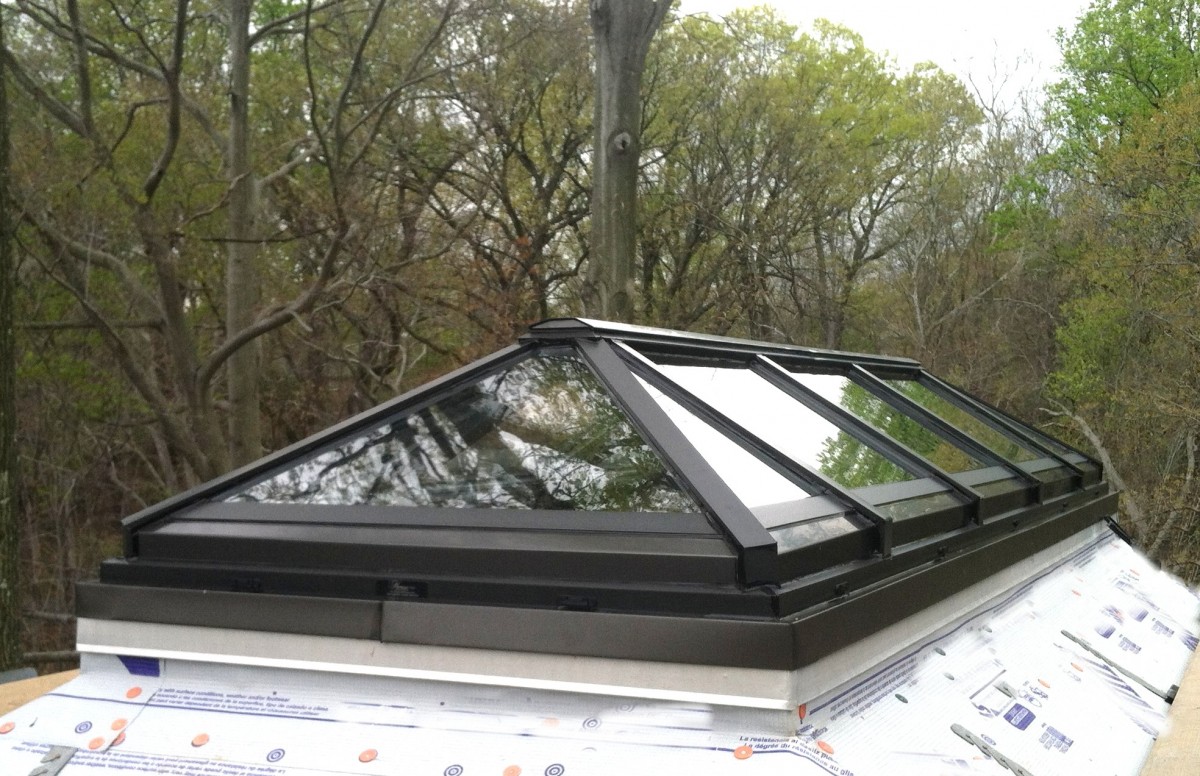

On the skylight front, that depends on budget. A friend installed skylights with sloped glass (looked like a hip roof house on the roof). That gives the glazing lots of slope and allows for relatively simple and comprehensive flashing. Very few points are relying on adhesive for water. They were way more expensive than I would ever pay though.
Something like this but smaller and simpler.
Very nice, but as you say BUDGET.
