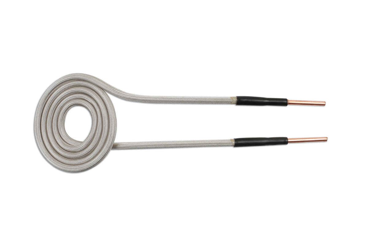

Went to do front tire swap on my bike and noticed that the head of one of the brake caliper bolts was partially stripped by the previous owner. Tried to get it off and it feels like it's seized.
I was able to get the brake caliper off on the opposite side so I could at least swap the tire out, but will need to get this rounded bolt out when it comes time for brake pad replacement. I have no expereince with removing such things.
What's the best way to remove it?
Heat it and use some penetrating oil and then try to take it off?
Thanks!
I have this induction heater you can try. It will only heat the bolt head (or anything else you surround by the coil), so it should be easy to limit heat damage to anything else.
Does this work? have you tried this, and where do you get something like that?

Works amazingly well. And it sure is fun watching it turn nuts and bolts or anything that fits within a coil red hot within a minute or two (and not the surroundings). I got it in preparation for doing some suspension work on my Subaru (sway bar links, control arm bushings, ball joints).
I might not have pulled the trigger at full price, but there was one on Amazon Warehouse Deals as a used item for $170. It looked brand new, and you could barely tell that one of the coils looked like it had been used. By the time I was done, it looked way worse.
Just to clarify, on Subaru ball joints, the ball joint pinch bolt rusts and seizes in the middle at the pinch, so heating the head of the bolt does nothing. You need to heat the bolt at the pinch, but since you can't get a coil around it I had to use a torch. If I had one of these coils, I might have been able to hold it next to it (like heating a frying pan):
