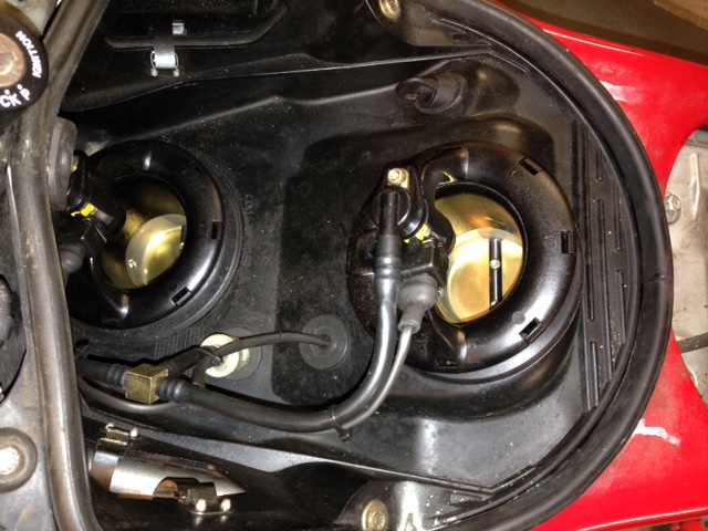

That said, hopefully he learned on my 998 before touching yours, but he tried prying out the tabs on the rear velocity stack/injector mount instead of simply turning the entire assembly counterclockwise to remove them. So some of those tabs are now broken and the rear stack sometimes pops off (presumably when I hit a really bad bump). And of course you can't just buy that one piece, you need to buy the whole injector assembly.
Pic showing tabs (not mine):
img_0528-jpg.39547
Fuel injector assembly (#4):
