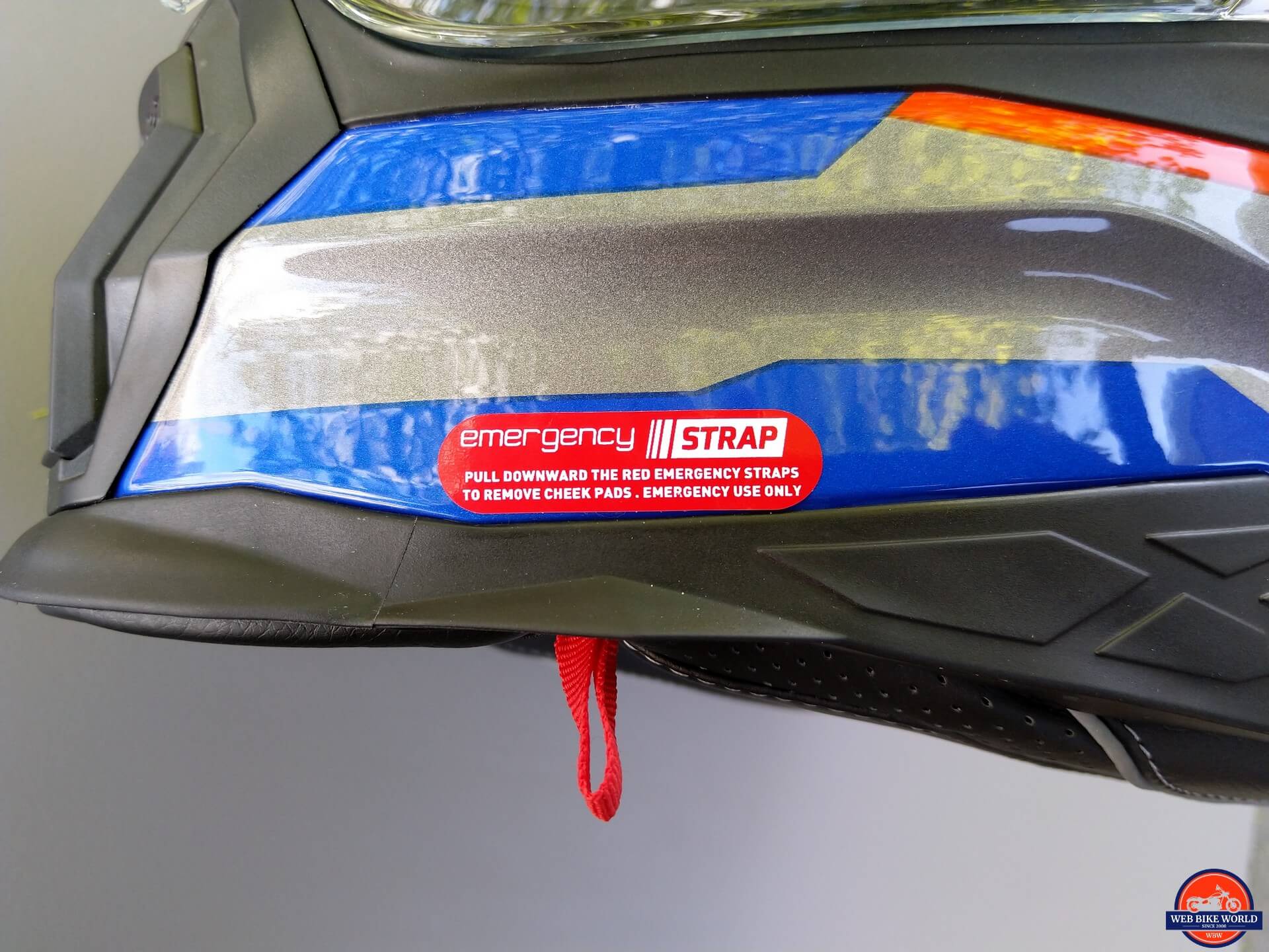

Some helmets also offer an emergency removal system in the event of an accident. There are tabs on the underside of the cheek pads which allow you to remove them first while the rider is still wearing the helmet, so you can take the helmet off more easily, avoiding any pressure on the neck or spine.
My Nexx helmet has this system:
