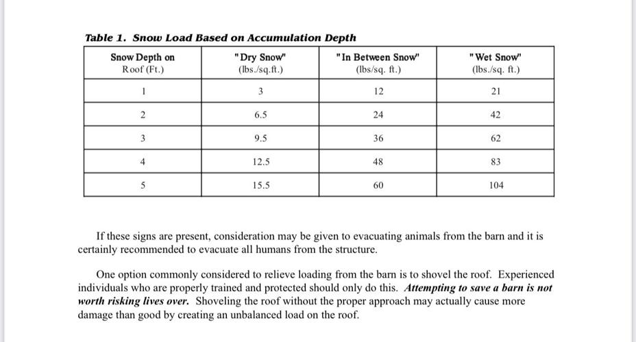

I think roof design snow load for southern ontario is on the order of 20 psf (for Windsor and Toronto, 40 psf for London, 50 psf for Barrie and Ottawa, 65 psf for Timmins). Not easy to hit with falling snow but very easy to exceed with rain on deep snow.

If I'm reading it right my 50 year old code book has graphs showing the GTA as 40 PSF. The minimum is 21 PSF.
Building code on line gives complex equations but maps show similar numbers.
Another site gives snow weight of 2 feet of dry snow as 7PSF, medium snow 24 PSF and heavy wet snow as 42 PSF, the worrying point. Ice is 5 PSF per inch.
The Intact number of having to clear at 5 cm (Two inches) got pulled out of a snowman's butt. Of course, it gives them an out if an odd situation comes up. Your roof was stressed by an earlier snowfall that you failed to clear.

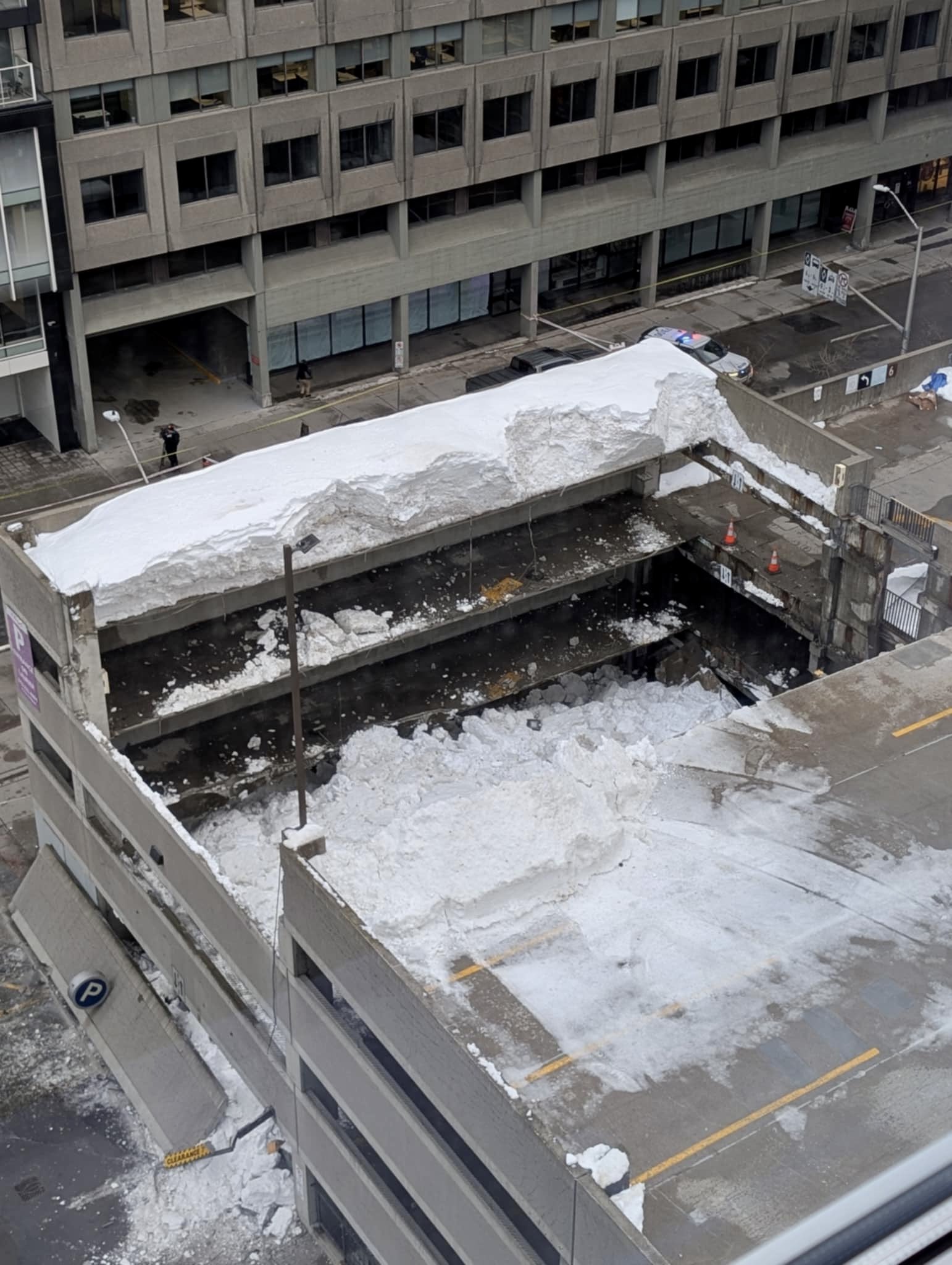

A flat-roof commercial building downtown orillia partially collapsed. Roof fell in, walls pushed out. Likely going to be demolished as saving it is too much work.
EDIT 2:
The commercial building in orillia was torn down today.
Ottawa lost a parking garage. Technically only partially collapsed but I can't see them saving it. All cars inside are destined to become pancakes. Insurance nightmare for the vehicle owners. It looks like the snow contractor piled all the snow on one side to keep some more spaces open on the top deck. I wonder how big their liability policy is?
