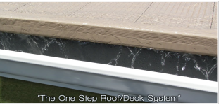

I need help in sourcing some aluminum decking.
My parent are looking to redo the decking of the 2nd floor balcony which has a patio underneath.
The decking NEEDS TO BE waterproof, meaning water CANNOT seep through the joints.
We found a source is the U.S. (LockDry® Aluminum Waterproof Decking from Nexan)
They do not have any distribution in Canada but they can arrange for shipping to this side of the border.
To avoid the exchange rate and additional shipping we are trying to source something local.
I found a place in Concord ON ( Aluminum Decks ) but numerous attempts of trying to reach them are getting us nowhere. I have yet to visit their "showroom" but will possibly attempt it. It doesn't look promising from google searches. Some "hinges Canada" business might be operating out of the same location/phone number.
As much as I would like to support local and make it easier for us I am doubtful with this local company.
Anyone have any experience with such products???
Thank you in advance.

When I needed to do that in the past I used steel roof on the bottom of the floor joists. A 2" furling strip at the outside edge to slope it. Then deck material can be anything.

I'm with @GreyGhost on this one. Remove current decking, put something underneath to channel the water wherever you want it, and then build the deck of whatever it is you want.
I think that opens up a LOT more options.

Another solution is a rubber sheet below the decking and allowed to droop in joist space. This puts the waterproof membrane above the bottom of the joists (except for the discharge) and allows any ceiling finish.

Not the question you are asking (I don't have an answer for aluminum decks) but if it was me and the stuff was hard to get or expensive...
-If there is a waterproof deck there already, can it be refinished/painted/repaired or overlaid?
-If not (they want to make it waterproof, just a deck now) I would likely go a more conventional route with slightly sloped plywood and then a water proof membrane and decking like is commonly done for balconies/rooftop patios over living space.
-Or the underneath approach GG noted if the decking on top is still in good shape. I do prefer option 2 as it does not create any possible space for animals...
Go look at the Trex website , complete system available, in Canada . Pull off your decking and install the gutter system, install decking of your choice. It’s designed for DIY , idiot proof and they have already figured out all potential problems . aluminum decking is stupidly expensive.
