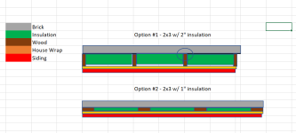

Ok...looking for some good guidance here...narrowing it down to 2 options for siding...
Option #1 - 2" insulation, and no work inside. Installation of the 2x3 vertically, and just cannot figure it out HOW to mount it to the exterior brick in order to be secure. Is there a bracket? Drill and Tapcon through the narrow side of the wood (issue with splitting)?
Option #2 - 1" insulation and update on the interior with time. 2x3 can be secured with Tapcons easily through the wide face of the wood.
Both options include gluing / PL of the insulation to the brick, as using the screws / Tapcons through it is tough to hit the mortar...
It's a little bit different than the previous schematic I threw up.
Thoughts? I'm tempted to buy some 4x8 sheets of 1" insulation and install it in the shed against the house...just to see if it makes a difference on that particular wall section.
Should I include a bracket to mount it? The metal studs that are for sale at HD?
That's literally the one item I can't get my head wrapped around...how to mount the narrow face of the 2x3 against the brick exterior.
