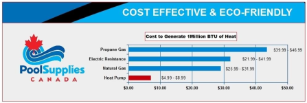

250k btu off a 50kbtu heatpump would be 5 hrs x 2.7 kw = 13.5kwh of electricity at approx .13/kwh. $1.75. Gas is about
.01/1000 BTUs so 250k would cost $2.50.
Now the average July temp in barrie on is 68f. You need 10btus/hr/degree/sq' of surface area to maintain temp. Typical 16x32 is sound 500sq' and typical pool temp is 80. So 500sq'x10btux24hrx12degrees = 1400000btu/day. That means a 50kw heater won't turn off.
You must have a solar blanket or smaller pool.
I based this round of cost by looking at the hourly energy usage. There are some hours that at $0.22 higher than most others. On nights it was cold, there are few low hours and most hover at the higher line. For gas $0.27/cu m. Energy content is ~35k btu/ cu m. Your $.01/ 1000 btu seems reasonable on the surface but by the time you add delivery and carbon tax you are about 0.70 to 0.80/ cu m (about $0.03/1000 btu). Heater is <80% efficient so it is burning about 20% more btu than make it to the pool. So that gets us to 250k*1.2*0.75/35k =$6.40 per 250k into the pool.
Both a solar blanket and a bit smaller pool (400 sq ft). Decent sun so it can easily go up a few degrees during the day from passive solar.
I think we were both off on the gas cost calc. My current cost is .52/m3 (.277 for gas, .097 Trudeau Carb tax, .147 delivery). or about . No matter how you slice it, a heat pump appears to have leapfrogged natural gas. I'm sold, it's only going to get better when overnight electricity goes to .02/kwh. I didn't proof this graphic, but I'm guessing it's fairly close.
BIL is putting in the pool and he said they went gas...but hasn't considered the cost of gas v electric / heat pump as frankly...he's fairly well off and doesn't worry about such things.
