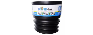

Biggest issue in joining pipes is I got nothing to grip to on the OD of the clay pipe. But if I can make it work inside then that may do the trick.
2 choices. 1641665654744.png1, a mole pipe connector ($3) or sliding the PVC inside then grout the joint. If you want to maintain a cleanout, put a Tee at the elbow point, then a threaded cap cleanout. I have a pic of this if you need one, I did this for the drain that connects my detached garage to the main house drain.
Plumber said not to reduce to a smaller diameter…but not sure what options I may have here but to go to a 3” or whatever fits within the clay pipe.
EDIT: ID of the clay pipe is 3.83”.
This is not a pressure line and the flow is very low. Changing to 3" drain tile will not be a problem.
