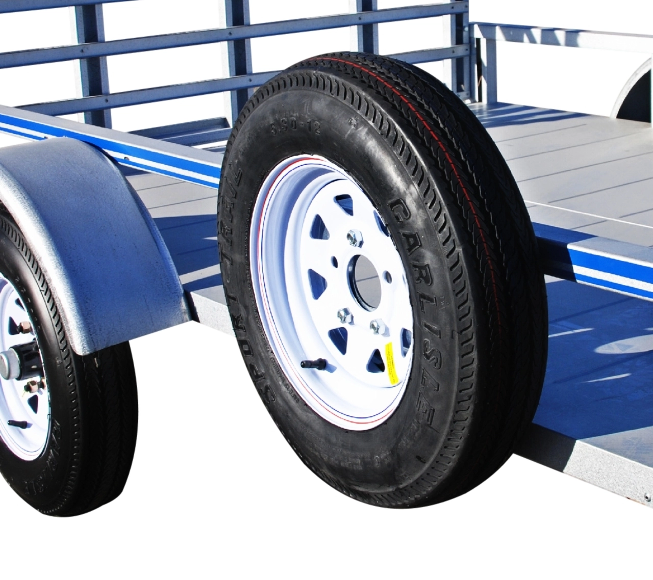

Move than mount to the side rail ahead of the axle.Trying to figure out a solution to my trailer… I have the spare tire holder and third wheel mounted. Third wheel I can move to the front to install a metal basket/carrier on the A frame….but any recommendations for the spare tire location?
That’s be great but I don’t have a side rail.Move than mount to the side rail ahead of the axle.
You could mount it on a 2x4 and stick it in the stake pocket. Easy access when you need it, easy removal when you dont.That’s be great but I don’t have a side rail.
Use the side rail that holds the deck (the same one that's holding your stake brackets). That part of the frame rides over the tongue rail so it's plenty high.That’s be great but I don’t have a side rail.
That’s sold long ago now!Use the side rail that holds the deck (the same one that's holding your stake brackets). That part of the frame rides over the tongue rail so it's plenty high.

Does the law require you to have a spare tire on the trailer for emergencies?I don't have it mounted to the trailer. I throw it in the car/trailer if I am making a long trip (on a short trip, I can dump the trailer and come home to get the spare). To maintain foldability, if you want it to stay with the trailer, I would mount it to the bottom of the floor (typical truck spare location). Completely out of the way but always with you and doesn't impede folding.
