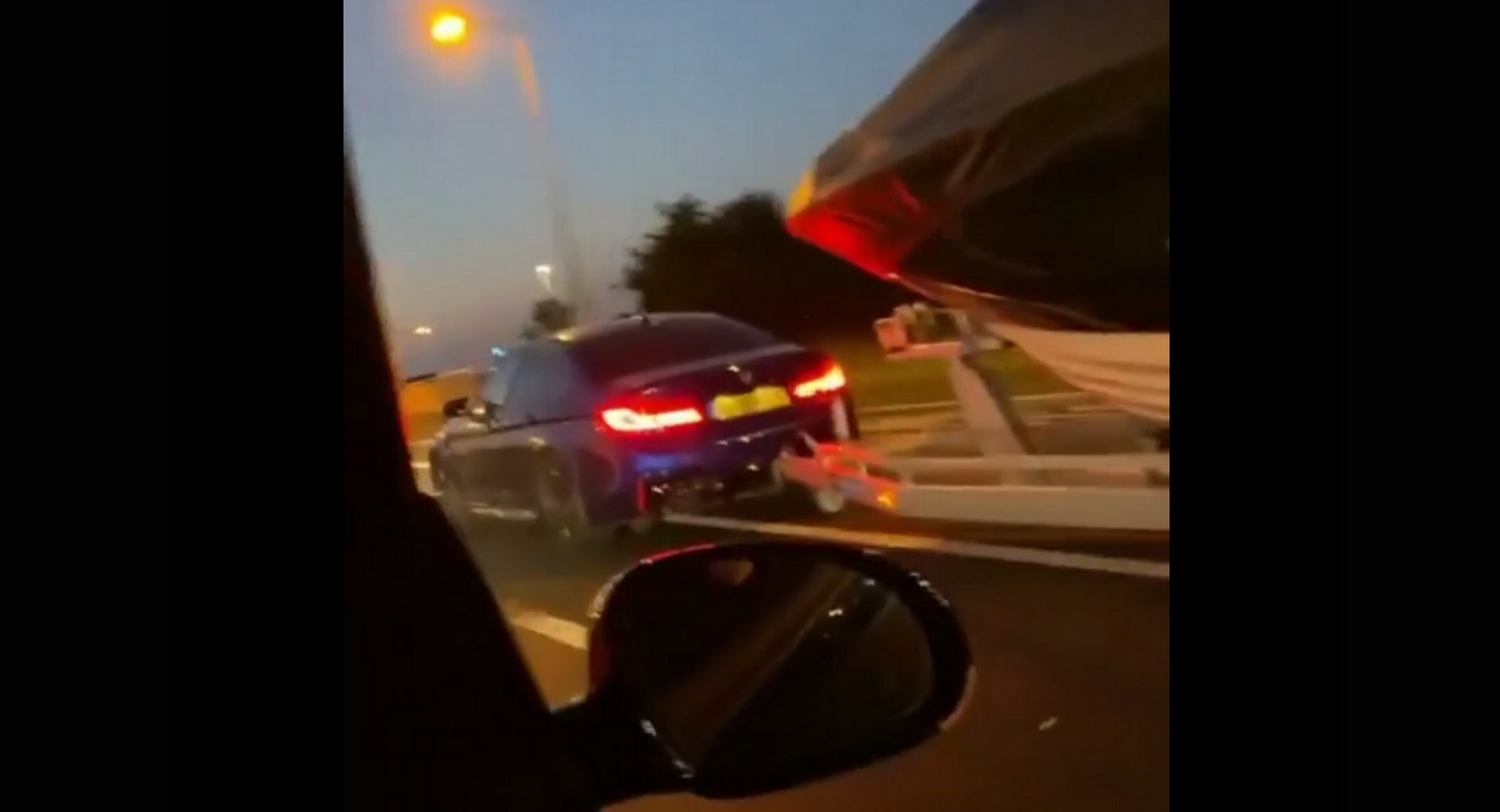

(...) A single-axle trailer behind a light-duty vehicle and without any yellow commercial-vehicle stickers involved, normally doesn't attract attention unless obviously stupid.
You mean like this? ?
ummmmm........
