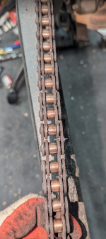

OK, so I took the wheel off and this is what the chain looks like.
Is this to tight?
I don't think I found any kinked links.
I feel like it should be moving more freely and flowy.
