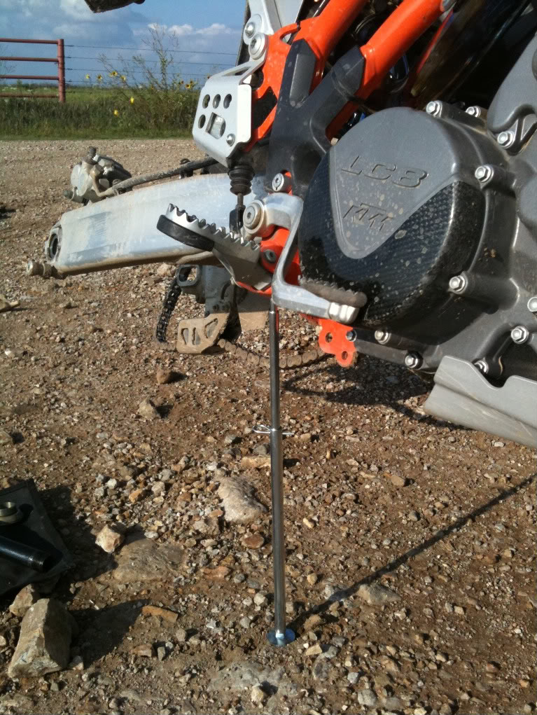

I've lubed my motorcycles without a center stand.
Lever the rear wheel off the ground by pulling the bike toward you using the front wheel and side stand as a two-pointed base. Make sure you have the front brake engaged.
Use your foot to rotate the rear wheel while it's off the ground, set the bike down again, lube that part of the chain and repeat the above steps to get at all parts of the chain.
Helps if there's someone else there to help you either lift the rear wheel or lube the chain, but you can do it yourself, it just takes more time.

For certain bikes a centerstand is not a desirable option. And if you're on a long trip, this is the quickest and easiest way to get your rear wheel up.
I have one of those doohickeys you made to add a leg on the other side of the side stand to simulate a centerstand, but really, just levering the rear up on the front wheel is so fast that I only use the doohickey for trail-side wheel removal.
