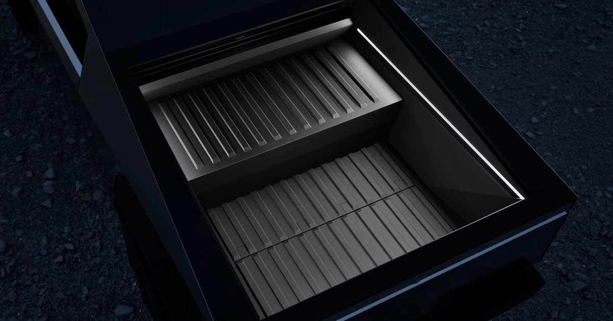

In other dumb-truck stuff ... there's no spare tire. You can buy one ... it eats up a ton of bed space. And it sits in the same spot where the range-extender battery goes. Don't know what happens if you want both. No more useful bed space?
Dumb idiot me would have re-packaged things up front to get the spare tire into where the "frunk" is now, maybe rearranging some things under the trunk floor to get a deep enough well for it, and then made it removable so that you could use the frunk as a frunk if you wanted to. Or, if that couldn't be done, re-package things under the back of the bed floor to get the spare tire into where the lockable compartment is back there. Again, it could be removed if you wanted to use that spot for storage.
I honestly don't think the spare is much of an issue. I really like having a spare tire personally, but I don't think many people are interested in installing it themselves these days. And half the trucks I see on the road with a lift or oversize tires (or both) have made the spare completely useless. Is a spare even still included on most "normal" trucks today?
I dunno what to make of the super high ratio steering. It will be made or broken based on how well they tuned it, and it seems like they did a good job? I can see at least one collision being blamed on it in the near future
I saw a wrangler today with stupid huge rims. Maybe 24x12? The "spare" was just a rim as with rubber on it there is no way it would fit. So so dumb.
Afaik, most trucks still come with a spare. My passenger car has room for a full-size spare without throwing it in the cargo area. Embarrassing and once again form before function from tesla. He needs to take some first year design classes and start focusing on form follows function.
