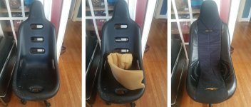

Here is my old PE bucket coveted to an "office chair". First pick is the raw bucket (grey spots are from a rattle can of primer that exploded in the car in the sun when parked after doing some roll-cage work). What I want to point out here is the transition from seat bottom to back and how the drivers hips/ass will be locked into the pocket, no reason that your braking force should end up anywhere but here. Second shows how thin the foam padding is, with a very little extra from the cover's quilting. Last what it looks like with the cover. Hope that helps.
As for mounting, I used a chunk of 1/4" steel plate as the mounting bracket in the car while we were setting things up. It was there for a while and street and track time and ended up all bent (from various "G forces" not braking) before I made proper brackets. This seat is the better part of 30 years old BTW.

That style of seat has the added benefit of no head bolsters. They could be useful on the track but for a sim seat, you want your hips locked in and your head free. The sample seat shown on the GT-1 Evo looks cool but it would suck if you wanted to make a sim where you could look around.
I can't tell if you've done this before, or if you just pick up **** really fast.
Also, as you have no lateral Gs the side bolstering is not very important so you really just want something with the similar transition from seat to back IMO. Side bolstering is a comfort choice in this application but in the end also adds some structural stiffness to the seat itself.
The PE buckets usually have four threaded inserts near each corner of the base and I think will be taller sitting (base to seat) than the gaming chair, so some metal fab work will be required. I know even compared to regular car seats if you mount the PE bucket up on the OEM tracks you gain a couple inches in height and have to drive with the sunroof open....
Thanks for the warning. Will take measurements from regular seats.
I also looked at the base again, sorry six bolts as there are also one on each side midway between the front and back. The base I made up for office chair conversion in the pic is also leaned back about 6° and it could use a couple more IMO. So not flat mounted but neither are most bucket seats to the tracks.
