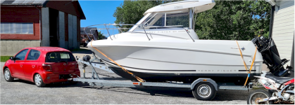

I won't take the bet, people do stupid things all the time. I think the guy that owns this Yaris used his vice to straighten his hitch.
