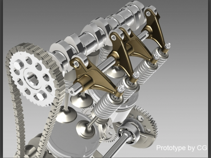

What is it that has hollow valves like that?You normally either have pushrods or put the cams in the head.
My old sohc is one example.That's why I went with "normally". There are some weirdos out there. I suspect there is also normal overhead cam with rockers but can't point to a specific example.
Nothing wrong with pushrods IMHO. They don't work for all engines, but for low revving high torque engines like many motorcycle v-twins, they can add reliability while reducing engine weight, height, complexity, and maintanence.I dunno, don't other bikes have a different type of valve systems. Plus everyone dumps on HD for still having pushrods
No idea which that cutaway is specifically. Sodium filled exhaust valves have been around for decades. Porsche uses them. Lots of others too. I have no idea about the hollow intake valve.What is it that has hollow valves like that?
Many bikes used ohc and rockers. I have a few in the garage... Honda Goldwing, Suzuki SP, Yamaha XV920R... and my Honda gennie.That's why I went with "normally". There are some weirdos out there. I suspect there is also normal overhead cam with rockers but can't point to a specific example.
That's my old SOHC set up except w/o the rollers. That and you get to adjust them thru a hole no bigger than a loonie.The old air/oil cooled Suzuki 600s and 750s had twin cams operating four valves per cylinder via rockers. Adjustment was so simple.
The latest Honda 500cc parallel twins use rockers and are DOHC. The new watercooled Triumph twins have a single overhead cam, four valves per cylinder, and rockers. No doubt there are many more examples.
The wackiest set up is probably the Africa Twin: single cam, shims on the intake side, rockers on the exhaust.
