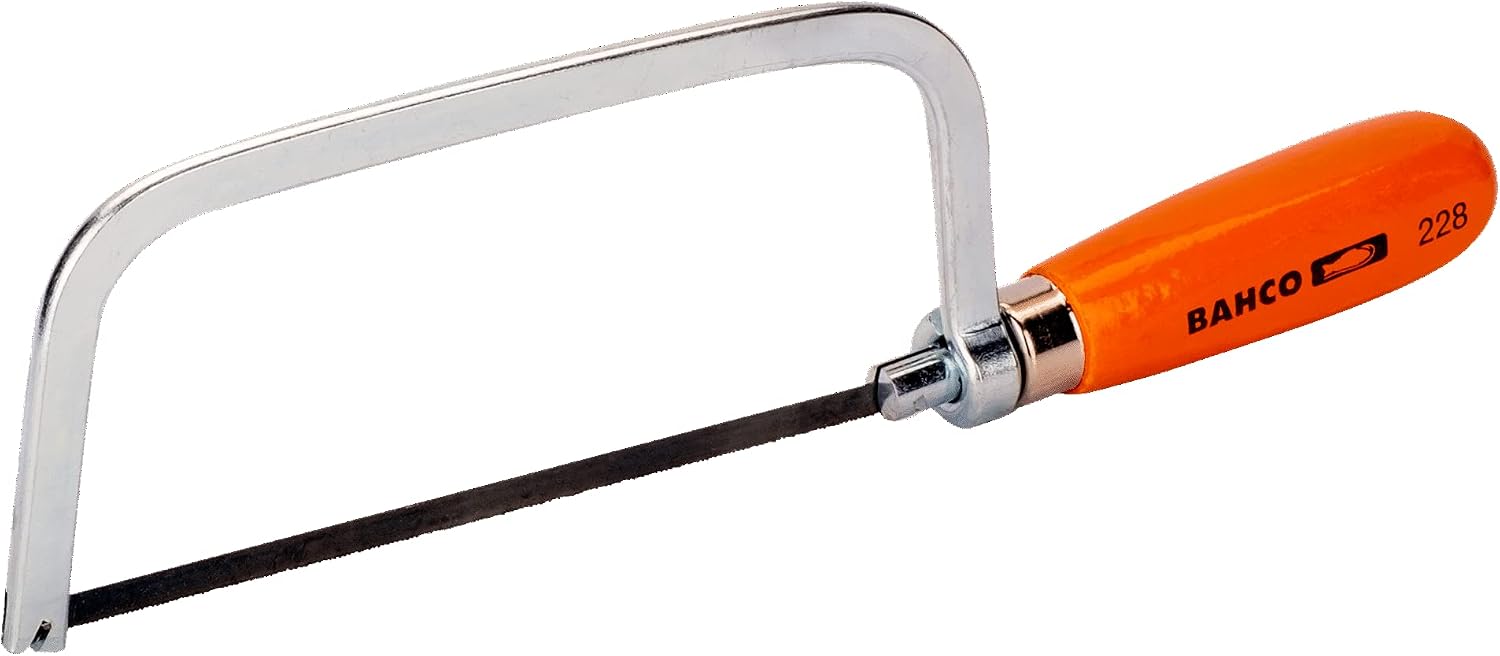

F3588442-3728-4F74-9486-7B985E06396F.jpegI think this should work so I’ll grab it today.
If it comes in tomorrow I’m good for the weekend.
Parts ordered. Now just to pull that mofo off.
View attachment 50911I think this should work so I’ll grab it today.
FWIW, I dont like that style of hack saw. I just hand hold a blade or use a mini hacksaw. Mini hacksaw are great for bolts too.
