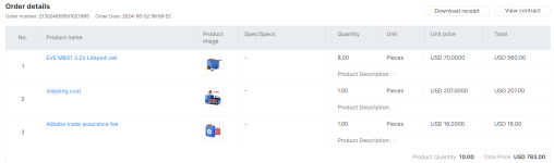

That being said, prices for building your own banks have came down substantially... last month I placed an order from China for another 8 cells to make a 24v DIY battery bank. These are the new Eve cells that are testing at 330 Ah each! Just over $1000 CAD including delivery for over 8kWh battery bank - lead acid is dead!!

That being said, prices for building your own banks have came down substantially... last month I placed an order from China for another 8 cells to make a DIY battery bank. These are the new Eve cells that are testing at 330 Ah each! Just over $1000 CAD including delivery for over 8kW battery bank - lead acid is dead!!

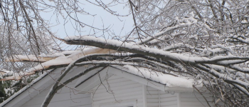

I remember that storm, left a few trees on my house.
