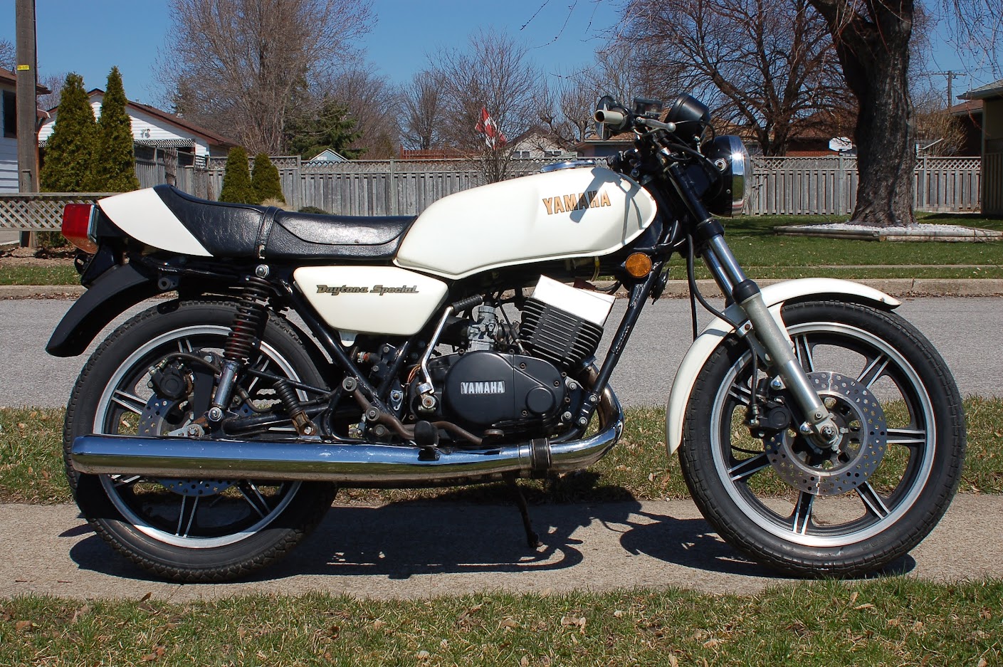

ACtC-3e8G-iR5aYNoYVm_VglGsFnb0PtSoWA9_Z-sHfuiH08ACyMypjbStPsMgptjCMfD0UBItdwF3msxqOGDNr4cvv72KvLjp_XFxaJBZv1J1eGcuo4kEh7uFdh_bXvZVrndUMQl6sLTuyx6IiZkwkMjbTE=w1410-h937-no
I have another RD350 LC chassis with an "unplated" ownership at my brothers. It was a bike I had for the VRRA
Its tweaked slightly as the steering head is bent about one degree to the right at the top. I was thinking about dumping it as its just taking up space, but considering what they are going for it may be worth sending it down to Framecrafters and having them pull it back. I should have enough parts lying around to do a bitza project.
