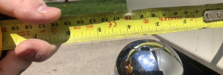

Anybody know the proper distance from bumper to ball that will allow good clearance?
Have about 3.5” to the middle of the ball. So 2” to the edge of ball.
Just need an afternoon with some paint and new grease for the wheel bearings
You shouldn't need much more than an inch in front of the ball once you're hooked up. The closer the ball is though, the higher the liklihood you ding the car while hooking up.
