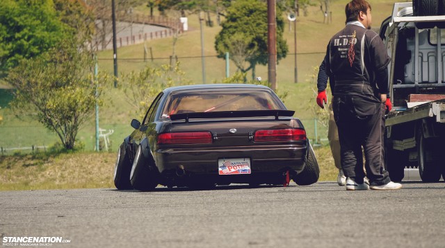

I saw a cambered ricer today and the tires didn't have the required clearance IMO. Could a cop pull it over and force some form of action?
AFAIK, if there's a legit safety concern, yes, they can demand that the vehicle be subject to an inspection. However, given the amount of rice junk out there as well as this new "stance" fad (that I just don't understand), and how little attention much of it seems to garner from the the police, I don't think it's something that's enacted very regularly.
There's a kid with an old BMW that I see driving around Oshawa fairly regularly with one of these retarded looking things. Someone tell me how that's safe.
