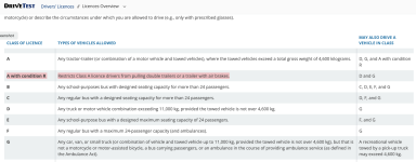

On paper, it's not legal to pull more than one trailer unless you have a full class A licence.
If you look at the licence classes you'll observe the following:
- Only the class A licence specifies "Trailers", pluralized.
- Even class D specifies singular, specifically.
- The class AR (special heavy RV licence) even spells it out that double trailers are not allowed.
The clear point is that unless you have an A, no doubles. Some people argue that G is allowed to blah blah blah, but when presented with the stats specifically saying that both the D and AR are specifically disallowed, they don't have a response. It doesn't seem to require a rocket scientist to figure that if someone with a class D licence driving a gravel truck (for example) can't haul 2 trailers, that Joe Blow with his half ton and a class G can't either. But some people will argue it.

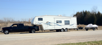

Here was my setup.
I got pulled over by an MTO on the 401. He thought he had me good until I presented my AZ licence. He even paced me out to see if I was legal length wise (6" to spare lol!) and sent me on my way. If I'd had a G I'd have been leaving my Jetskis on the side of the 401 and having to come back later.
Further to all this, doubles are not legal in lots of places as well, regardless of personal / recreational vehicle or commercial truck. Try driving into New York state with 2 trailers and see how far you get, for example....

I am writing seeking clarification regarding an issue that generates much debate on social media and various forums, particularly in those specific to the Recreational Vehicle community.
To preface the discussion, I am a class AZ licence holder who is active in the trucking industry, with almost 30 years experience. I am also an active recreational vehicle owner who travels extensively during my vacations, and on weekends.
The topic of towing multiple trailers often comes up in the recreational vehicle crowd and generates a great deal of confusion regarding the legality thereof.
There is a great deal of ambiguity and areas open to interpretation when it comes to licence classes and what is allowed with one class vs others which has led to a great deal of confusion, as well as a great deal of potential misinformation spreading online.
The main question remains, can someone with a regular passenger vehicle Ontario class G drivers licence pull more than one trailer legally in the province of Ontario?
When looking at the licence classes, the only class that specifically includes the wording "trailers" (as in multiple) is the class A licence. The class D licence is specifically only valid for a single trailer, and even the new class AR (A Restricted) licence which is aimed specifically at the recreational vehicle market goes so far as specifically mentioning that holders of this licence class may only pull a single trailer.
Yet as someone who spends a lot of time on the road, as well as somehow who follows a lot of RV discussion groups online and on social media, there are countless people who are not only pulling multiple trailers in a recreational configuration (typically a boat behind a camper), as well as continued insistence that this is perfectly legal with a class G licence.
Some report having even gone so far as speaking to MTO employees, and in one case, even an OPP officer, only to be told that hauling 2 trailers with a class G licence is perfectly legal.
This seems questionable in many respects, and certainly concerning is other respects, mainly due to a lack of training and related experience, but it also seems incredibly odd that the Ontario class AR licence, a licence which is specifically aimed at heavier and more complex RV's in the province of Ontario, and has a mandatory education component, specifically excludes pulling multiple trailers.
Citation:
https://drivetest.ca/licences/licences-overview/
It seems counterintuitive that both the class D as well as the class AR, both licence classes that have special training and testing requirements are not allowed to haul multiple trailers, but reportedly many are being told doing so with a regular passenger-vehicle class G license is perfectly legal.
Unfortunately, when referring to the Ontario Highway Traffic Act, as many refer to when this debate comes up online, there is conflicting information that presents itself, leading once again to this never ending debate.
As a class A licence holder with an exemplary safety record and decades of experience including recurrent training and testing requirements, I find this rapidly increasing practice of "recreational doubles" being operated by class G licence holders concerning, given the lack of training and skills, especially when one only needs to observe many of these double trailer combinations actually out there on the road to often see that they are sometimes unstable, and the drivers are often unable to properly operate them when the need arises in tight quarters or challenging maneuvering situations such as tight corners.
I trust you will be able to clarify this matter once and for all, and the justifications and reasonings behind this being legal (in the face of the above realities), should that actually be the case.
If indeed it is not actually legal, it would be prudent to ensure that relevant law enforcement agencies are made fully aware of such, as based on what is being posted online, it seems evident that there are a lot of people being given bad information based on misinformed officers.
