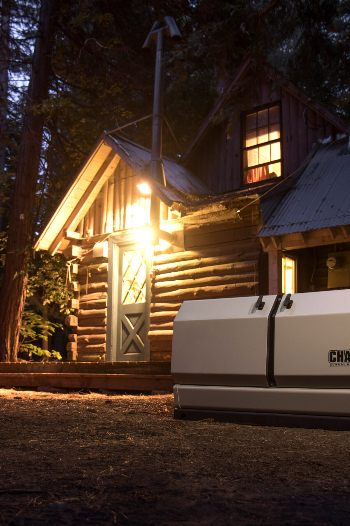

Fiddles, it seems what you're looking for is a fully automatic standby generator. Look online at Home Depot's website, they sell the Generac models - I actually deliver them to a lot of the stores. The smaller (6000w) units can be had for <$3000, although you'll easily be in for probably another $2K for installation by the time you have a gasfitter run the gas lines and an electrician do the wiring. But it's going to do what you want it to do...as long as you can get it situated somewhere permanent where the gas and electrical hookups are workable given your housing situation. And 6000w is plenty for careful usage, even being enough to run an element on the stove or small appliances like a toaster oven so long as you're not trying to run everything that's high demand at the same time.

When you get serious about Home stand by,
Check out Champion Home Standby Generators, they are good for the price, and come with 10 year warranty on Parts. I'm a dealer for Champion, so of course I would push them. Having said that, we install more Generac 22.5k models, as the Champion's largest they offer is 14.4k. Nonetheless, the Generac cost more and only have 5 year warranty and 14.4kW is plenty enough for most peoples needs.
Consumer Reports highly rates the Champion and has noted it as a "Best Buy", we've also found they are less finicky then the Generacs as they don't have as many nanny's and safeguards in place and way more electronic wizardry that trips up the generator. The Champion is simply more basic and mechanical, but it just works. In one trailer park we installed a Champion in, he said the majority of residents had Generacs, and the service guy was a regular visitor there for problem service work.
At the end of the day, they are both good for different reasons, choose what's best for you.
