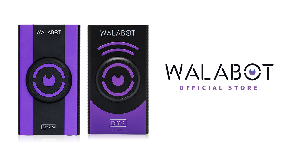

If you see it advertised too often, you know they have focused their effort and money on advertising instead of focusing on the product. For drywall, I like franklin sensors. Reliable, easy to use and a fraction of the money of that toy. Like many companies, they have gone slightly of the rails with dozens of models when they should reduce their range to two or three and focus on making them the best they can be.I see thing thing all over YT
The world's most advanced stud finder
Walabot DIY 2 & DIY 2 M - advanced wall imaging tools for home renovation projects. Find studs, pipes, wires, and more with confidence. Walabot DIY 2 with Expert Mode to show you all the hard-to-see objects inside your wall. Walabot DIY 2 M to quickly give you the location of your studs/pipes/wires.walabot.com
I have seen this as well and am tempted to try it. But no one is willing to send me a free sample.I see thing thing all over YT
Not sure, it could simply be focused ads via YT. But not having used one I have no idea if it works well.If you see it advertised too often, you know they have focused their effort and money on advertising instead of focusing on the product. For drywall, I like franklin sensors. Reliable, easy to use and a fraction of the money of that toy. Like many companies, they have gone slightly of the rails with dozens of models when they should reduce their range to two or three and focus on making them the best they can be.
