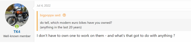

I thought you were done?
you still havent told me which euro bikes you owned. (I have 2 seperate screen shots, one where you say you never owned one, the other says you did)
