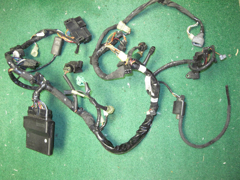

$150 whole wiring harness
Nice find!! i just messaged him.
