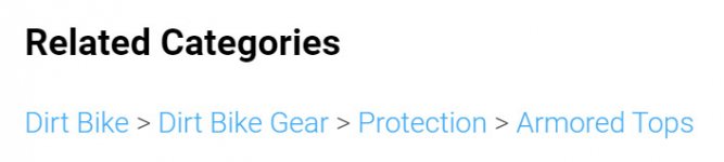

That is a base layer and doesn't seem to have any abrasion protection at all
Sent from my Redmi 7A using Tapatalk
Yeah, it's meant for dirt biking, where you're not going as fast as on street and if you hit the dirt, it isn't as abrasive as pavement.
Even says so in the category:
