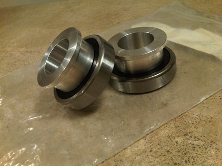

I think most guys use "captive spacers" to make things easier, it's really not hard once you do it a few dozen times.
What is a "captive spacer" and how does this help? Do ppl custom fab these spacers?
spacers that are attached to the wheels, and don't fall off as your trying to install the wheel....You can make them yourself or there are bike specific kits. All the aftermarket wheels I have bought came with captive spacers...

I looked around for captive spacers, couldn't find any on ebay.. anyone sell or can make those for me? I don't change wheels so often, but when I do---I always find white hair later on...especially after a rear wheel change.
We made our own for GSX-R. Almost more work than it was worth(then again my lathe is a peice of shat). If we can streamline it we'll be peddling them at the track
The ones I've seen aren't all that exotic. Just like a standard spacer with a little lip on the inside end. The spacer is held in place by the dust seal, it just snaps in. If you're particularly rough with your wheel change, you could still knock them out.

I don't know how I didn't think of that before, but my dad owns a small factory in Europe with all kinds of machinery for making virtually anything from metal... maybe I can make specs for him to make me a few. Assuming I measure the stock spacers, what else needs be added to make it a captive? Just a small lip on the side that goes inside, and a bigger outside or what? Same depth I suppose?
