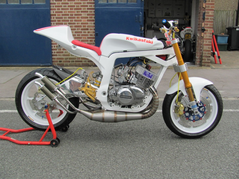

Really want to build something like this:
http://www.asphaltandrubber.com/wp-content/gallery/kwikasfaki/kwikasfaki-cabbie-2.jpg

The bike in the pic is from a UK builder, he does awesome work and must have deep pockets considering some of his projects. I like how he changed the tank badge on this one. Lol
There were allot of sweet bikes there that day in Campbellville, I was drooling over the Eddie Lawson replica! Wow!
Yeah I read a lot of his build thread on some forum. Pretty sure the engine was from an ex-drag bike, so must have some serious balls. Love the Kwikasfaki name too.
