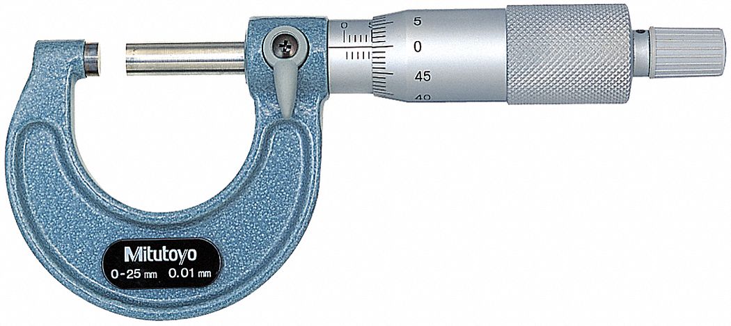

How far off is the micrometer? Anvil faces parallel to shim? Do you have a gauge block to check the micrometer with? If not, measure your fattest feeler gauge. If your feeler gauges are off, this whole program can be a disaster.

When I checked the .005" feeler...the number on the micrometer showed .0045 - .0040 but I also pressed hard on it to get there.

Does your micrometer have the clicking end to give you a standard pressure? Does it read zero when closed? Try your thickest feeler gauge and see how it compares.
I can reset it at zero. But it's an old/simple/electric unit...so may not be the most accurate. Not sure.
Mitutoyo Absolute Digimatic
Something like this...without the AOS
That's not a micrometer. That's calipers. This is a micrometer. Using calipers to measure down to .001 is optimistic.

I wouldn't rush off to spend money. I too only have calipers (but I refer to them as verniers). If you don't "push hard" you likely come pretty close to the .005" which it should be. Half a thou (.0005) isn't going to make a huge difference, we're talking motorbikes not space shuttles.
Again go with GG's suggestion and measure some of the feeler gages, gently and see how you fare. I would be really surprised if your feelers were off. Actually Mitutoyo is a good name, I'd be surprised if it's off too.
