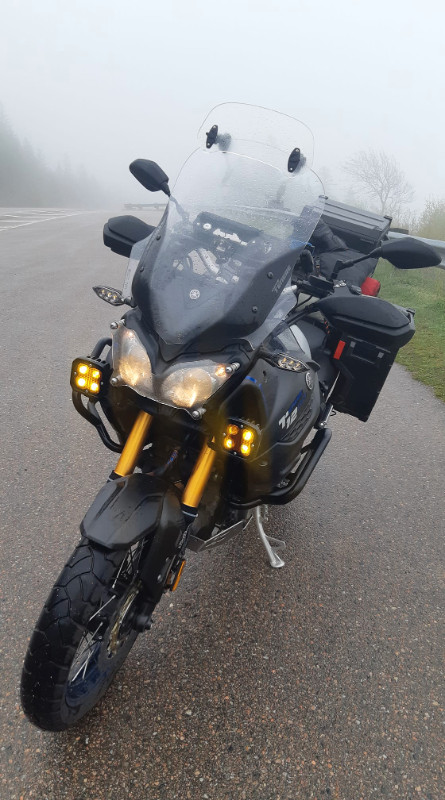

Finished taking my personal stuff off the Yamaha.Ad is on kijiji.Let the pelican parade begin.
